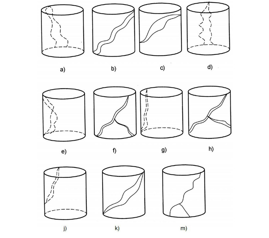

4) Assessment of type of failure.
IS: 516 (Part4) provides two set of images i.e. Images of Satisfactory failure of specimens and Images of Unsatisfactory failure of specimens. The clause No B-1(f) of IS: 516 (Part-4) states that if cracking is observed during testing from failure pattern, the core test result can be discarded. So in order to reduce the viability of core strength, the tested cores should be observed for satisfactory failure or unsatisfactory failure.
Fig-4 Satisfactory failure of specimen. (Ref-a)
Fig-5 Unsatisfactory failure of specimen. (Ref-a)
